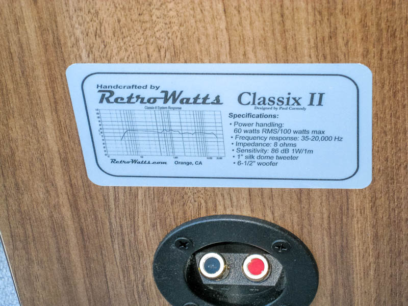

The crossover was easy enough. I used the sticker since it makes nice built in (aka 'never gets lost')  documentation, in case service is ever needed someday.

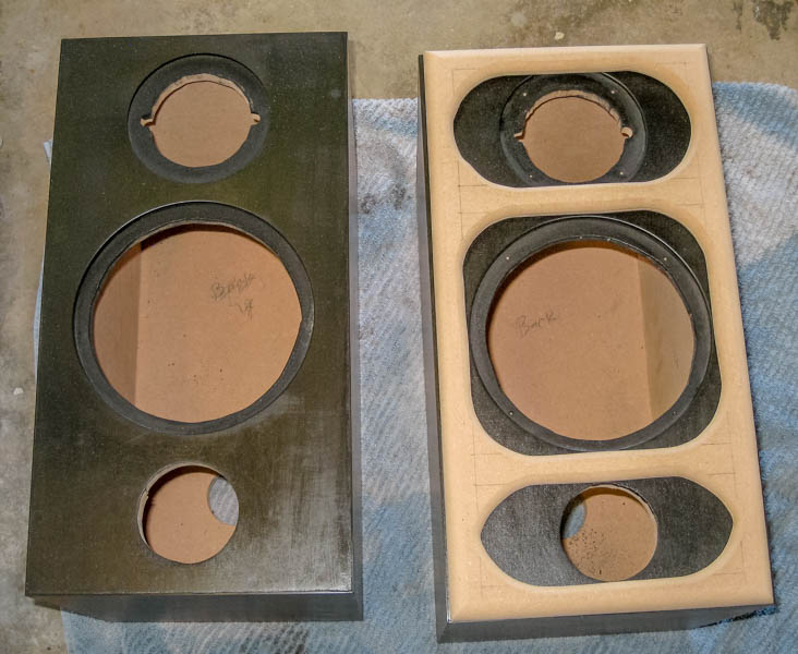

Made my own router circle cutter and got good enough results for the part of the hole that shows.  I just used my jig-saw for the hole the speaker goes through.
After doing some tests on scraps with deck screws, I started to wonder if MDF was all that great of a choice.  But I researched how to screw up MDF without screwing up  ;)  and discovered that they make special screws just for MDF.  They worked great, except for one that I put in a bit crooked and it cracked the MDF.  I just wood glued and clamped the injury and put a new screw nearby.  After successful dry assembly, I took it all apart and reassembled with wood glue and some small strips of scrap MDF braces on the long corners.
Since I did not initially use the neighbors table saw, my boards were a bit "off" which lead to some minor alignment issues when assembling.  But some wood filler takes care of that.

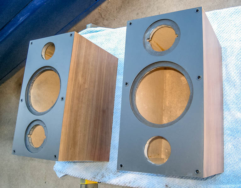

Sides all veneered and shaping the grills.
Some paint over the black stain to get a nice flat black look.  I didn't get a photo of it, but I did put the self adhesive foam damping material in there.

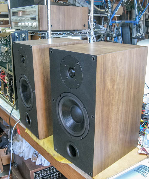

And  now all assembled!  Just need to finish the grills.
These speakers will be paired with the Marantz SR 4000 you see in the background.

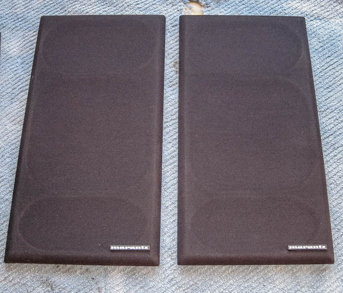

Since these speakers will be paired with the Marantz receiver, I have badged them with some home made Marantz emblems (with apologies to Paul Carmody).
The deception is minor, as the truth is on the back.

All finished and they sound great with my Marantz SR-4000 !

Nice job! I like the grill treatment you chose. And the Marantz, of course. :-)  It's a great looking combo and reminds me of the stereos of my youth.
How did you create the label for the back?

Post by dcairns » Sun Feb 11, 2018 8:03 pm
I bought some some full sheet (8.5 x 11) Matte Silver Labels from Amazon.   You can print them on a laser printer.
"Mr-Label® Extra Large Full-Sheet Matte Silver Label Adhesive Labels – Scratchproof Waterproof Stickers for Company Information | Wine Bottle - Laser Print Only (25 Sheets)"  currently $12.
There are also die cut labels available in various sizes.  I just cut mine with a roller paper cuter and trimmed the corners with a little hand punch that gives rounded corners to paper.
I printed the Marantz logos the same way, and put them on some bits black plastic sheet.  Kinda fussy work sanding them down so size as the plastic warps a bit with heat from my belt sander.  Hand sanding was easier as I got them close to the size. And just glued them on with a dab of glue to the grill.
