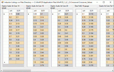

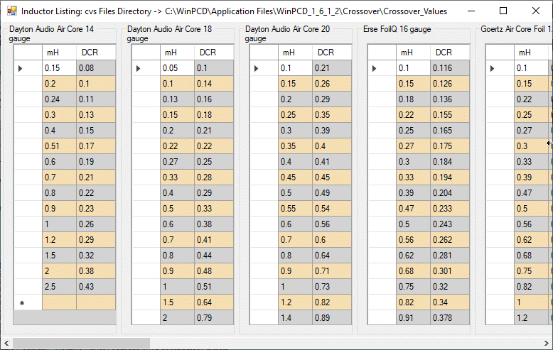

WinPCD v1.612 - Inductor Listing Form
Post by dlr » Sun Jan 08, 2023 11:19 am
I've added a new form window that the user can call up from the System page. It displays a set of csv file data with inductor info by manufacturer/vendor. It shows the inductor value/DCR (mH/ohms). This should make it easier to finalize a design with actual inductors, especially for the DCR values that a key part of a design.
More details at my web site.
